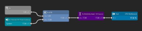

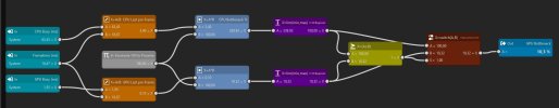

I have uploaded all my software sensors with screenshots in case it helps anyone.
Have fun with it!
