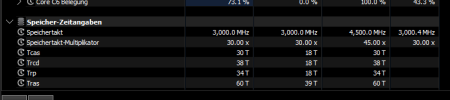

Oddly, the RAM clock rates are also displayed at an increased level, as are values like FCLK uclock and various voltages.
I've also noticed that these strange spikes occur much more frequently and are also worse with the 9950X3D than with the previous 7950X3D.

Iam sure its a hikkup, many values are normal, but when the hikkup come, its 50% more or 100% more. Its very good to see with the ram. 3000 4500 and in rare times 6000. I know when the SOC voltage go over 1,4v or 1.5v its a instantkill. like from the OC video from roman/der8auer on the 7xxx
