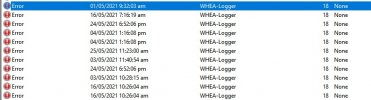

Hey everyone,
System Info:
Ryzen 5 3600 4.2ghz @ 1.125v Allcore
B450M Mortar Max Bios: 7B89v2D Agesa 1.2.0.2, previously 1.1.0.0 with no improvement.
Chipset Driver: 2.13.27.501 - 2/4/2021
Gigabyte RX 6700 XT - 21.5.2 Driver
Sfc /scannow - chkdsk - DISM, no problems.
PSU - Seasonic Core GM-650w(Gold)
30mins Asus Realbench, ~200% mem test pro stable, all kinds of real world load use stable prior to MAY 2021, 5 hour gaming sessions, 3 hour video rendering etc. General use Temps under 72C max load,, <60C gaming. Often left on 24/7.
Then randomly, over the past month at idle, things like youtube or launching a game started triggering a blackscreen/crash with Cache Heirachy Error, this has happened mostly over the past 30 days after setting HWinfo to start with system & simply leaving it on. (I was using it less prior & not running it 24/7),, now originally at the start of the month, I was getting this error on Agesa 1.1.0.0, & it continued after updating to 1.2.0.2 in an attempt to resolve the problem on May 10th, with no improvement,, over the month of May I had the Cache Hierachy Error ~11 times at seemingly random times on random Processor APIC ID's, sometimes with two different processor APIC IDs causing a cache error at exactly the same time.
After the crash and attempting to reproduce the issue, I could not force it to crash again by performing the same actions via applications, but sometimes it would crash when left idle again without me noticing, for only a few hours of idle. (HWinfo open), so I did not even recognize some of the entries until taking a closer look.
At first I tried increasing Vcore by +0.05v & SoC(1.050>1.100v) thinking it was my undervolt idle voltages, or some kindof degradation, with NO improvement before I stumbled across this thread a few days back mentioning HWinfo, which should have been fixed on the current version '7.04' that I was running,, nevertheless I decided I'll avoid using HWinfo to rule it out & see what happens, as well as disable GPU ULPS via Afterburner as it was the other prime suspect on other idle crashing threads, after the CPU voltage increases did not seem to help. But I was running ULPS default for months prior without issue. (Maybe something to do with Resizable BAR, CPU & GPU cache & something HWinfo is doing between core parking & idle just a theory.)
So anyway, onto the 3rd day now and the issue has not returned but still early to know for sure, anecdotal I know but just wanted to share, I even reverted the previously suspected CPU undervolt values to what I originally tested as load stable at the same time & its simply been rock solid(so far), & I've left the system to idle for a few hours multiple times, between 3 hour gaming sessions with ReLive recording etc, followed by long idles or minimal but normal desktop use.
Here's the log.
Processor APIC ID's
01/05 - 11
03/05 - 8, 11
04/05 - 5 & 10
16/05 - 8, 0 & 12.
24/05 - 5 & 12.
25/05 - 8
I tried to find some pattern of the same cores throwing cache errors,, nothing conclusive imo, core 2 is the fastest in CCX 0 & tends to sleep before Core 1 & 3, but only after CCX 1 is usually completely asleep,,, core 5 is fastest in CCX 1, core 4 is second fastest,, cores 2, 4, 5 & 6 sleep the most when watching Ryzen master at desktop but cores 4 & 8 usually sleep before 5 with core 2 sleeping last /w 1 & 3 the last ones left awake.....(feels like a riddle, which core is most likely to error?)
TLDR: Started using HWinfo daily in May & started getting crashes(not knowing it might have anything to do with HWinfo), I was on 6.42 & updated to 7.04 on the 18th, the version change didnt seem to help,, still had multiple cache heirachy crashes. Prior months before the crashes I would only run HWinfo when benchmarking or stresstesting instead of 24/7. Now ~3 days since keeping HWinfo closed & not a single error. Will keep posted as nothing conclusive yet, give it another 2 weeks before I'll know for certain.

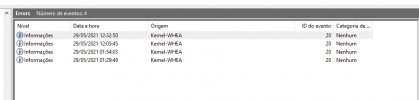

Hi guys and gals.
I have a problem here. My system is generating Kernel-WHEA (ID 20) errors and CTD (Apex), only when hwinfo64 (current v7.04-4480) is running. I have the event logger set to alert me if any WHEA occurs.
System:
ASUS TUF Z490 WIFI PLUS (LATEST BIOS)
INTEL I7 10700K
NVIDIA 2060
Log-file attached. Had an error at 12:31 or 12:32.
Thanks.

This is an Intel system with NVIDIA, exactly the opposite of what was causing issues in the past. Do those errors also result in BSOD or shutdown?
Try to disable monitoring of some sensors, i.e. NVIDIA GPU to see if that will stop producing those errors.

This is so strange. Apex will generate WHEA correctable errors and crash to desktop only when monitoring tools are open. Tested with MSI afterburner, HWINFO64 and LibreHardwareMonitor. If I have none open, I can play error-free or without CTD's. I still check for WHEA via event viewer messaging me via task scheduler if an error is logged. The CPU if OCed and is stable on longs runs of AIDA64, ASUS RB, PRIME95 AXW. RAM was also tested with long runs of TM5 and HCI.
