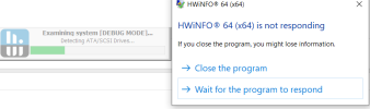

when i want to run hwinfo it is stuck on detecting ATA/SCSI drives
deeperkk
I have tried reinstall it and i also tried to end it task in task manager
